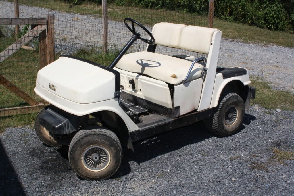

The pictures are of when I first got it. Since, I've spent 40-50 hours on the engine, rebuilding carbs, getting a exhaust system welded, rebuilding the seat with diamond plating, moving things, like the fwd/rev handle over, putting on a new fan on the front, adding lights, etc, etc...
Here's a couple of pictures.
