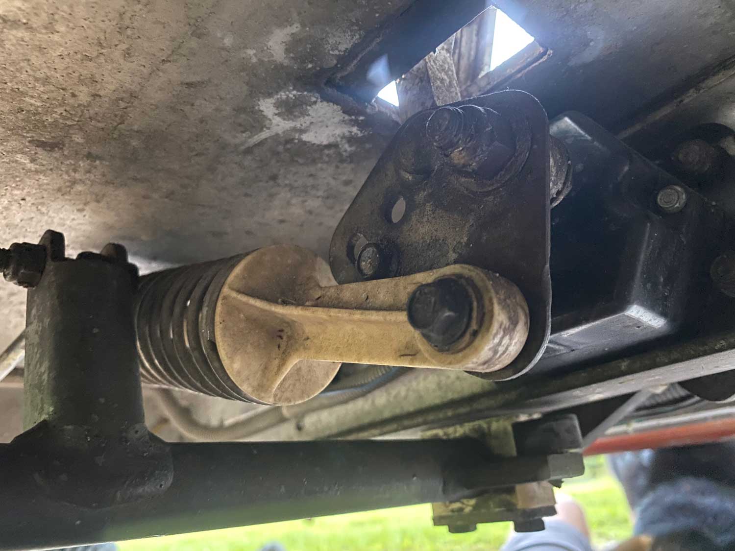

The cart is a 20 year old six seater but it has been modified by the previous owner and by me. It looks like this:
That pic is from April and the back seat is off because I had just installed a 48 volt lithium battery. It was at about that time that the accelerator started acting weird.
The accelerator sensor box under the pedal looks like this:

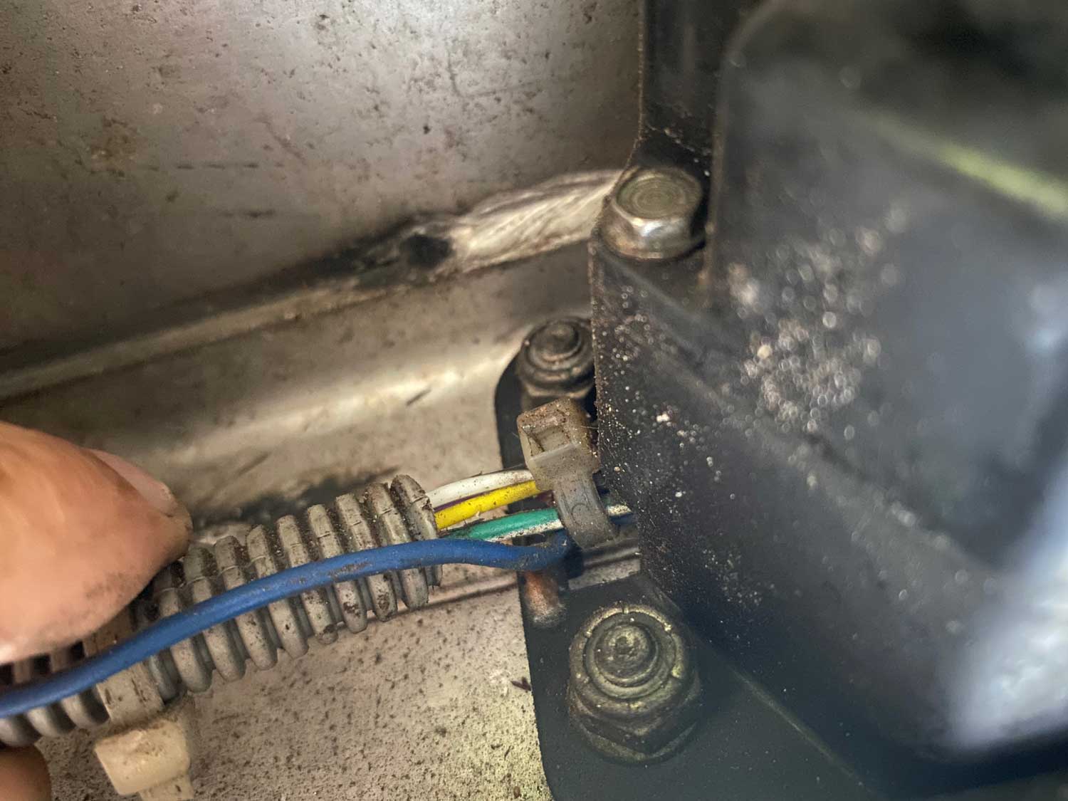

And has wires coming out the back that look like this:
I can't see a label anywhere on it. The cart has a motor and controller package from Hi Performance Electric Vehicle Systems, installed by the previous owner. The controller is a Curtis model 1238-5601.

Wait a minute. I just saw this thread. I looked at this picture and have a question.TomBugAccel.jpg The bolt head I can see bang in the middle of the image looks to be contacting on top of the damper/spring arm. If it is, it would restrict movement of the operating cam for the pot box. Can you confirm if this passes the damper or comes up against it. I wonder what it does? is it a throttle pedal limiter and has it slipped down to the bottom of the slot?
TomBuggy
Member
Wait a minute. I just saw this thread. I looked at this picture and have a question.View attachment 10263 The bolt head I can see bang in the middle of the image looks to be contacting on top of the damper/spring arm. If it is, it would restrict movement of the operating cam for the pot box. Can you confirm if this passes the damper or comes up against it. I wonder what it does? is it a throttle pedal limiter and has it slipped down to the bottom of the slot?
That bolt moves away from the spring/plastic damper when you accelerate. It's as close as it gets in the pic.
As for what it does, it's one of three that attach the pedal and its bracket/linkage to the Pot Box. I think. I'll know more when I get it apart.
