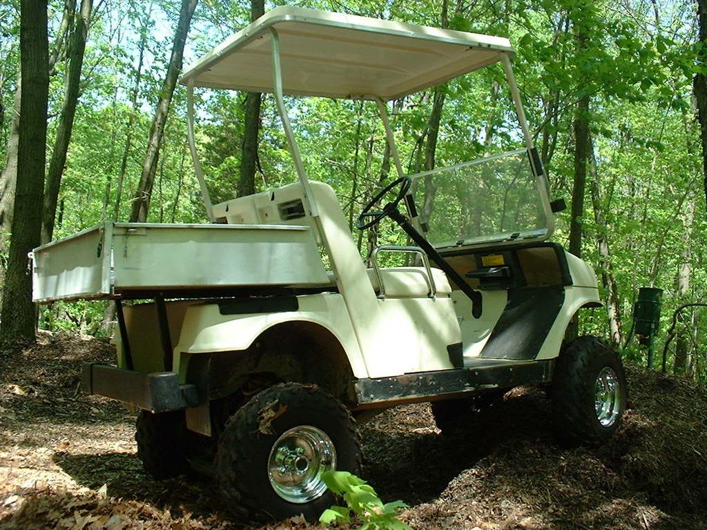

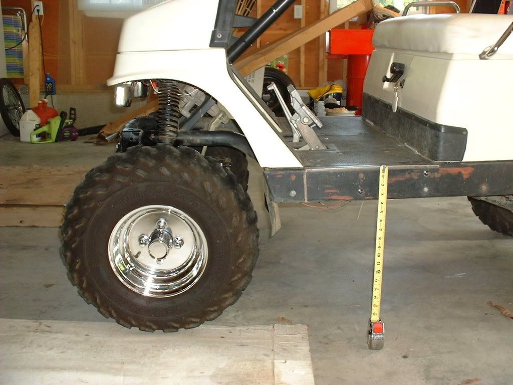

Start with this Height!
You will need these tools:
Take all old Suspension off:
Install NEW Double A Arm
The new height:
