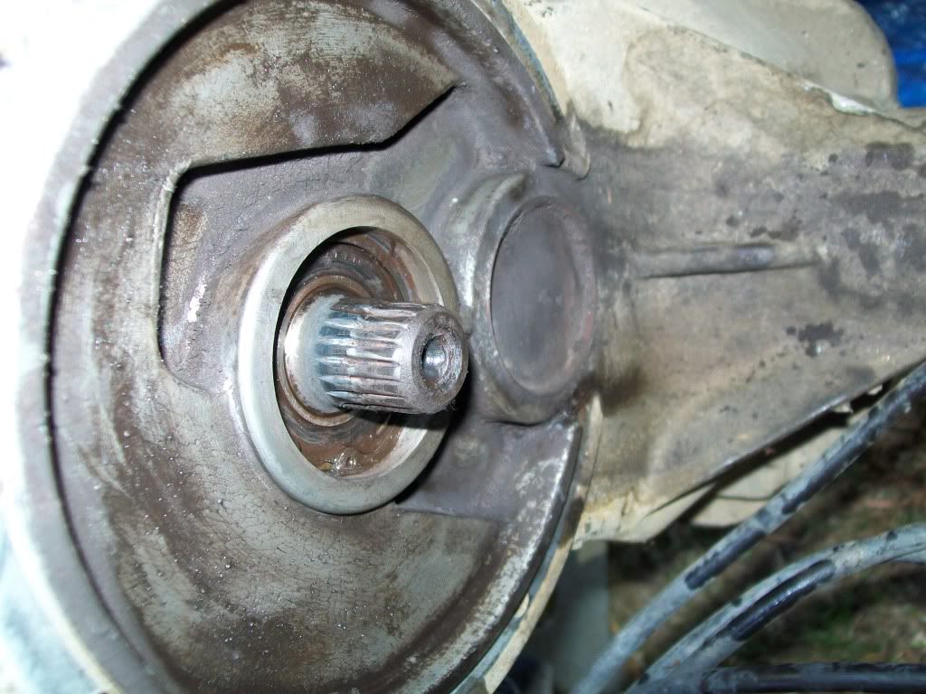

well I took the motor out and found the input shaft and the splinbe connector on the motor completely worn. I would imagine the input shaft on the diff can be replaced fairly easily. I don't see any reasonable way of changing the connector on the motor. could someone give me ideas of my options to fix this? here are some pictures of what I found to clarify things
