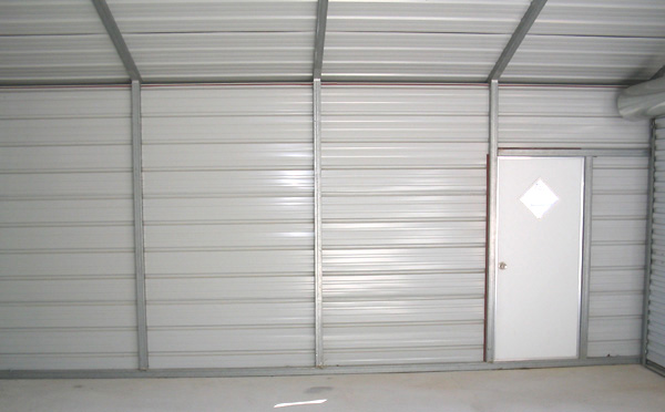

My dream is to have a new 40x60 garage building, but at the current construction price quote of 30,000 for the structure only, it's not happening soon. I know how to weld, would it be stupid to try and diy a metal garage?
The structure does not look overly complicated.
