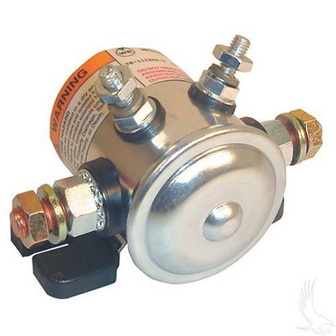

Most of the cheep solenoids on Amazon are junk and won't last very long. Golf Cart Tire Supply has a White Rodgers solenoid for the EZGO gas golf carts that should do the trick.
